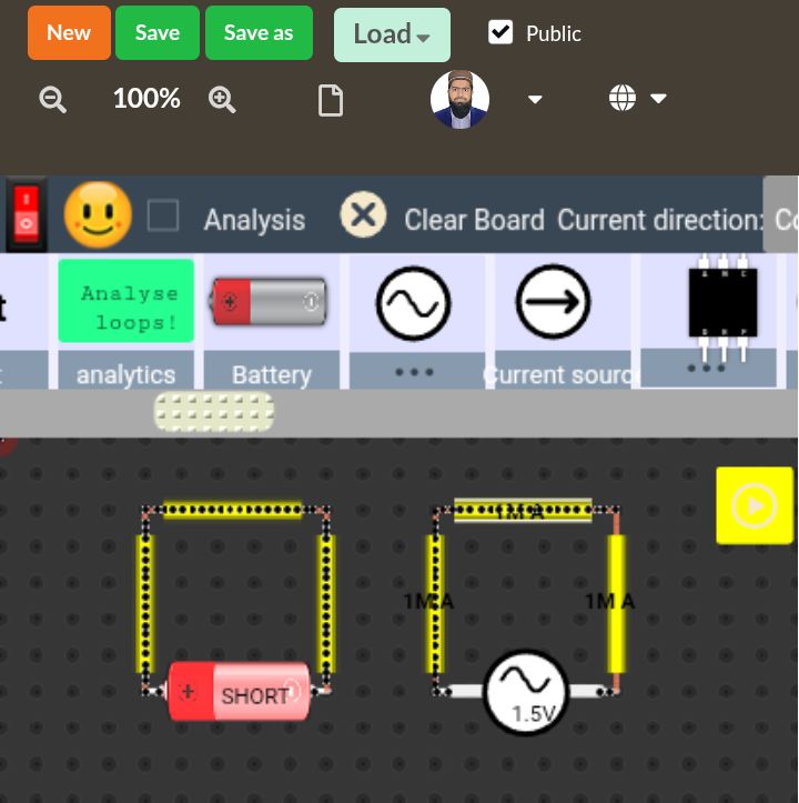

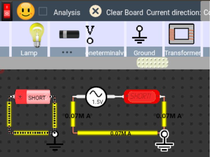

1. Short Circuit Between Power Supply Terminals
If we directly connect the positive (+) and negative (−) terminals of a voltage or current source using a single wire with negligible resistance, the simulator will immediately detect a short circuit.
What happens in DCAClab:
  • A visual warning is triggered
  • A Red colored indicator
This helps users understand why a direct connection across the source terminals is dangerous, mirroring what would happen in a physical lab environment.

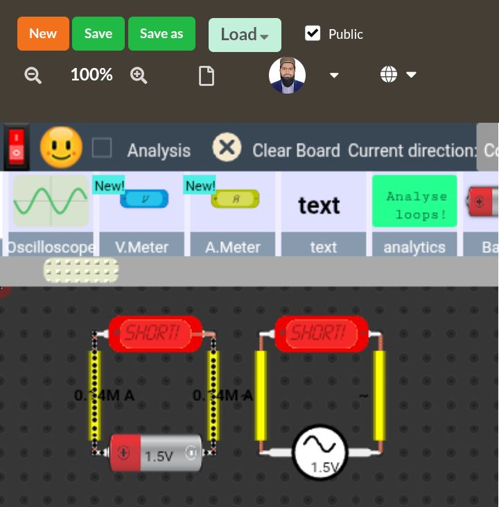

2. Short Circuit Through Incorrect Ammeter Usage
A common mistake in circuits is placing an ammeter in parallel with a voltage source or component. Since an ideal ammeter has nearly zero resistance, this creates a low-resistance path, leading to a potential short circuit.
DCAClab’s response:
  • Detects when the ammeter is incorrectly placed
  • Highlights the short-circuit current path
  • Warns the user and provides correction advice
This ensures users not only fix the circuit but also learn proper instrumentation practices.

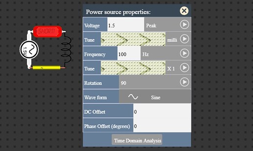

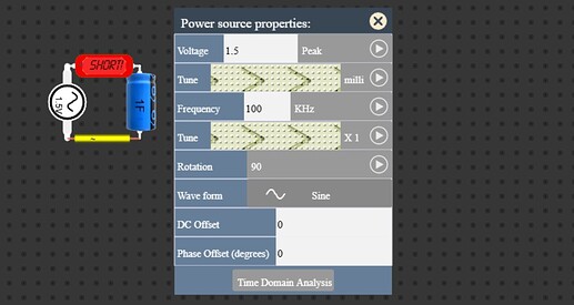

3.Short Circuit via Low-Impedance Reactive Components
In AC circuits, components like capacitors and inductors can behave as very low impedance paths at certain frequencies, especially when:
  • Capacitors act like a wire at high frequency
  • Inductors act like a wire at low frequency
DCAClab now simulates this frequency-dependent behavior. If the impedance of a component drops too low due to circuit configuration or signal characteristics, it triggers a dynamic short circuit warning.
High Frequency in Capacitor
Low Frequency in Inductor

4. Incorrect Grounding and Loop Creation
If a user creates an unintentional loop between power terminals or ground points with no load or resistance, the simulation recognizes this as a zero-impedance path and notifies the user of the short circuit condition.

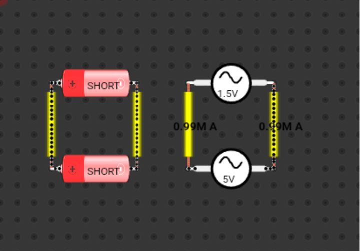

5. Parallel Voltage Sources

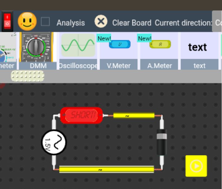

Short Circuit is occured when two voltage sources are connected in parallel with different voltages. To show AC short circuit, DMM or Ammeter is required in DCAClab .

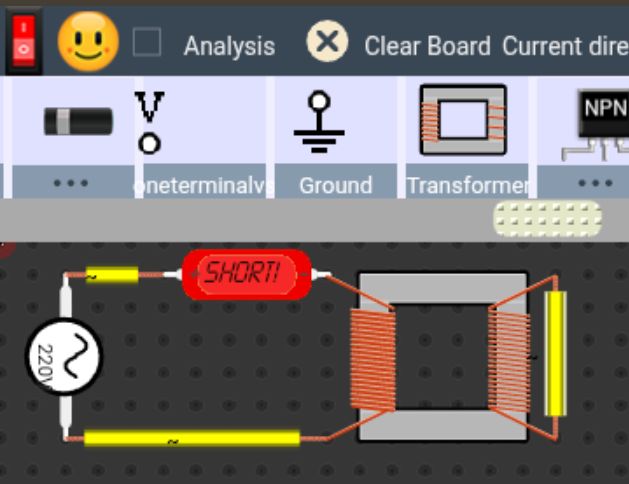

6. Secondary Coil Shorted Directly in Transformer
Secondary coil short

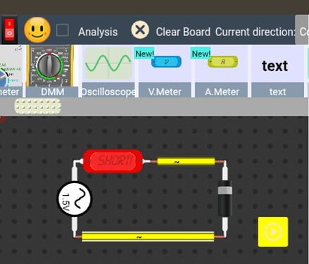

7. Diode or Diode Bridge Shorted in AC Source

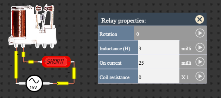

8. Relay Short Circuit for 0 resistance of coil
In the relay, the coil has a certain resistance that limits the current flow. By setting the resistance to 0, there is no resistance to oppose the flow of current. As a result, the current flows uncontrollably, leading to an excessive flow of current through the circuit. This is essentially a short circuit condition.

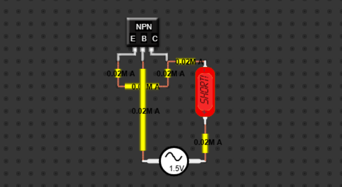

9. Emmiter and Collector directly short in Transistor
collector-emitter short in NPN Transistor

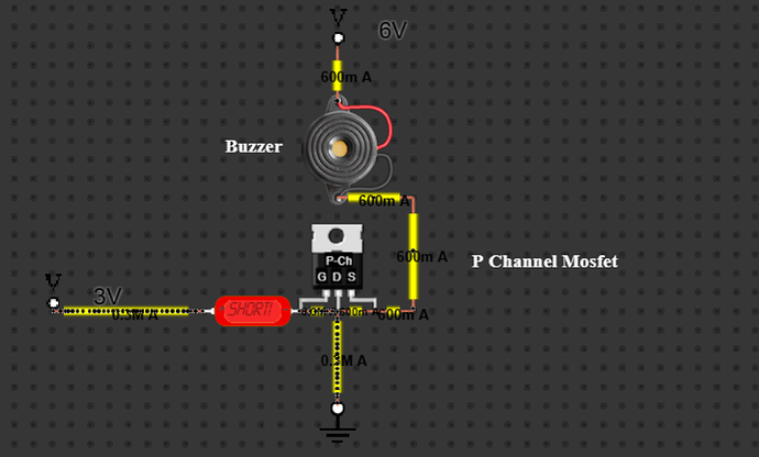

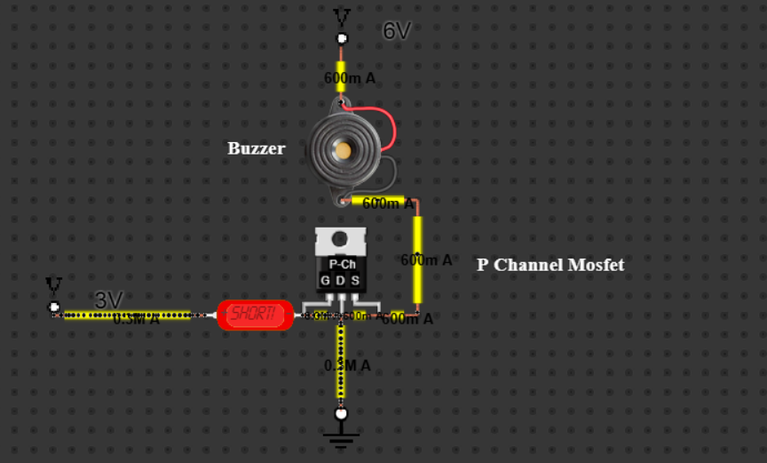

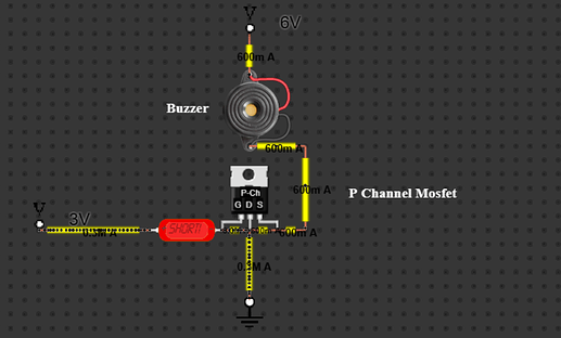

10. Gate, Source and Drain Direcly Short in P and N Channel Mosfet
