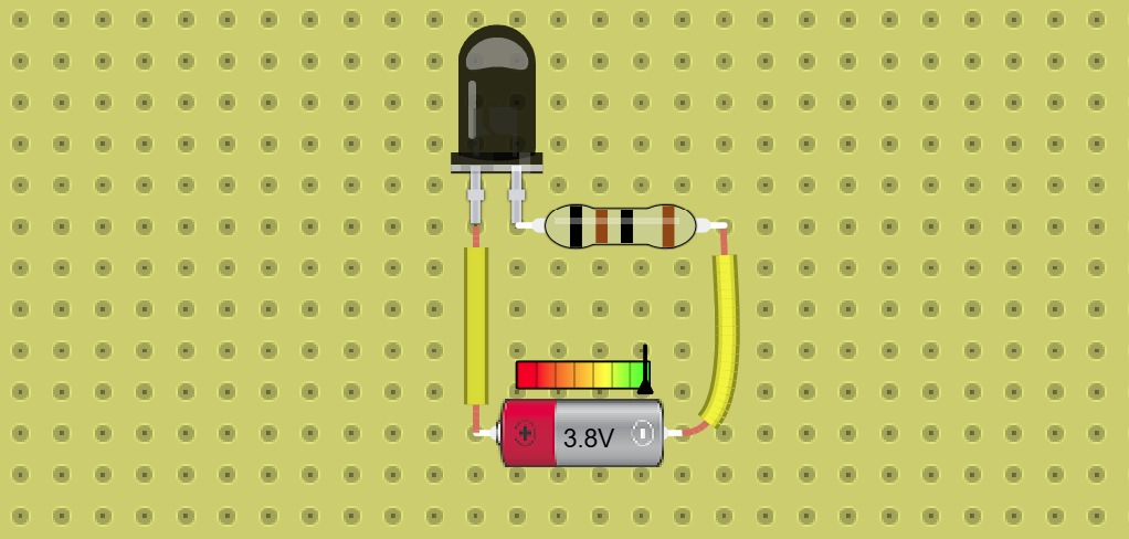

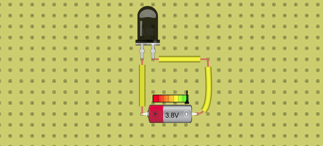

LED without Load:
LED with Low Resistance:
Note: Basically the purple LED burned out at 3.85V without load(Resistor) or low resistance. We have to know, if we use high voltage and high resistance, no leds will be burned out.

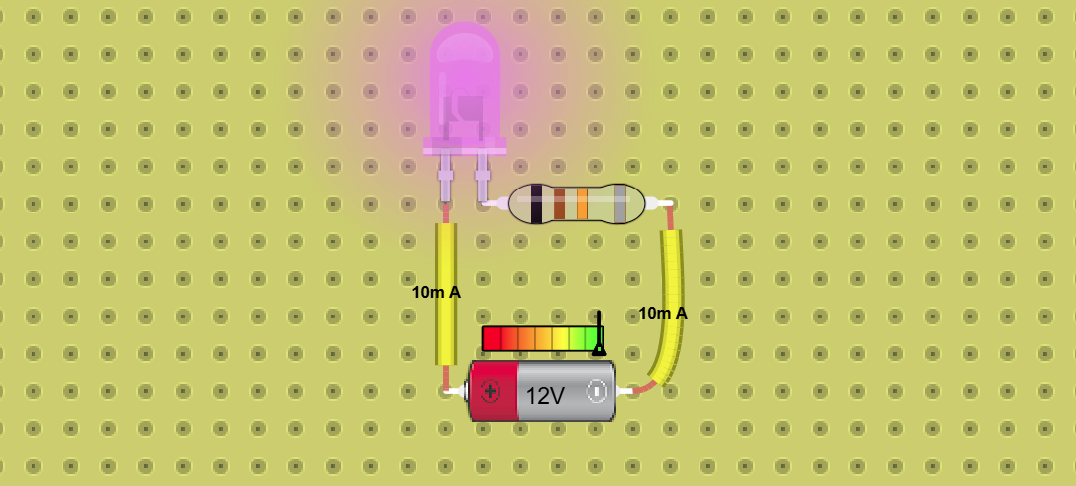

LED Operation in High Voltage and Resistance:
